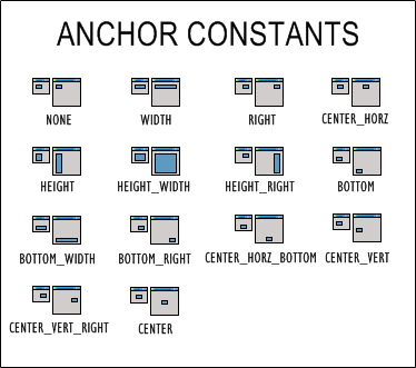

Using skSetAnchorControl is very easy, you just have to provide the handle of the specific child control and use one of the CONSTANT below:
  %ANCHOR_NONE                = 0
  %ANCHOR_WIDTH               = 1
  %ANCHOR_RIGHT               = 2
  %ANCHOR_CENTER_HORZ         = 3
  %ANCHOR_HEIGHT              = 4
  %ANCHOR_HEIGHT_WIDTH        = 5
  %ANCHOR_HEIGHT_RIGHT        = 6
  %ANCHOR_BOTTOM              = 7
  %ANCHOR_BOTTOM_WIDTH        = 8
  %ANCHOR_BOTTOM_RIGHT        = 9
  %ANCHOR_CENTER_HORZ_BOTTOM  = 10
  %ANCHOR_CENTER_VERT         = 11
  %ANCHOR_CENTER_VERT_RIGHT   = 12
  %ANCHOR_CENTER              = 13
To help you using the good one, print this:
