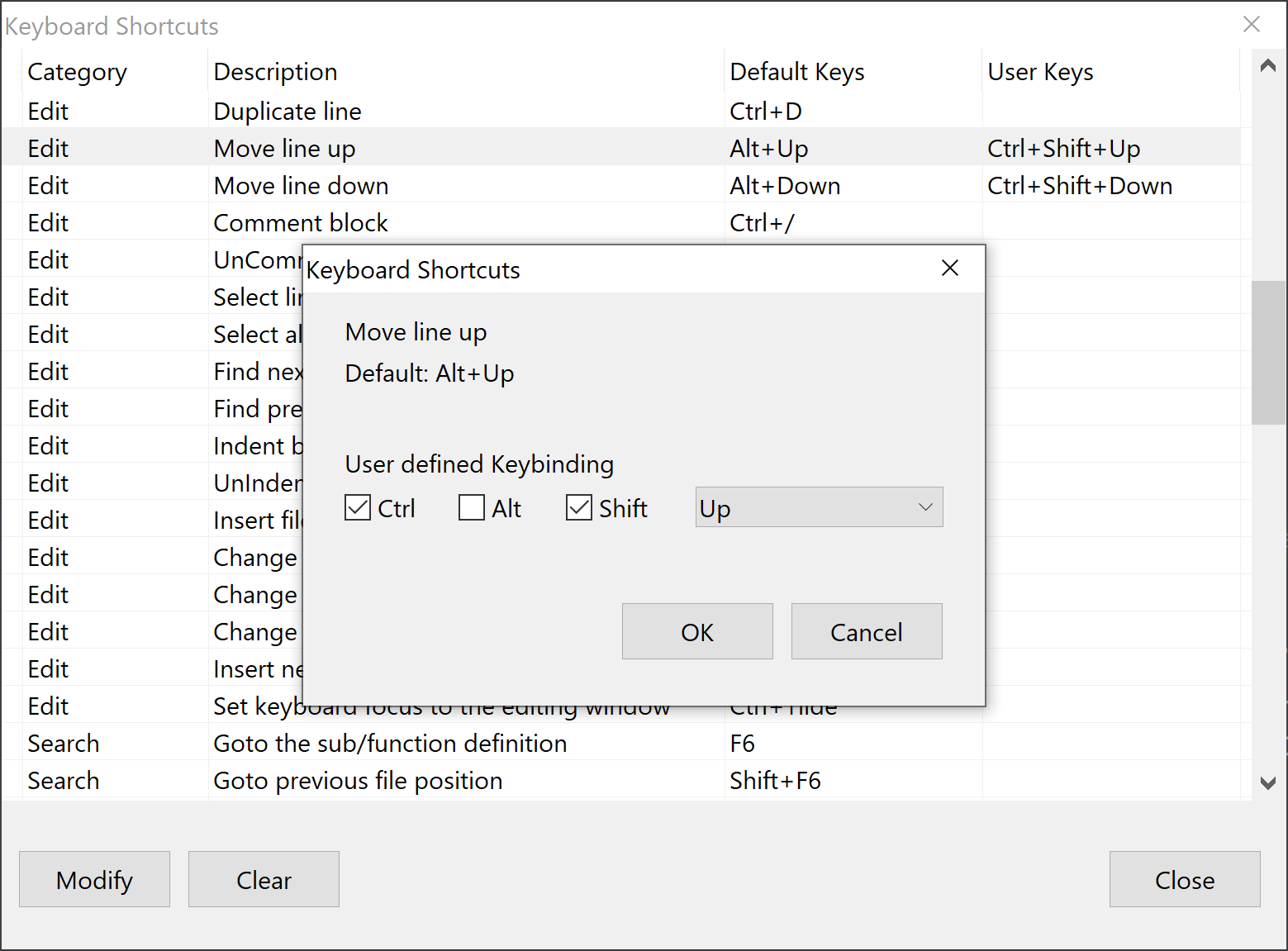

#29
Here is today's accomplishment. A keyboard bindings map editor. You can now easily assign/re-assign your own user bindings to the various actions in the editor. Creating your own user defined keybinding simply overrides/replaces the default action. This is something that I've wanted to include in WinFBE for a very long time so it is satisfying to finally have it done. Granted, the dialog is not themed... none of the popup dialogs in WinFBE are themed (yet).
I have also finally finished the top tab control. That was an interesting programming exercise writing all of that from scratch. The result is awesome and looks so much better than the default Windows tab control.
